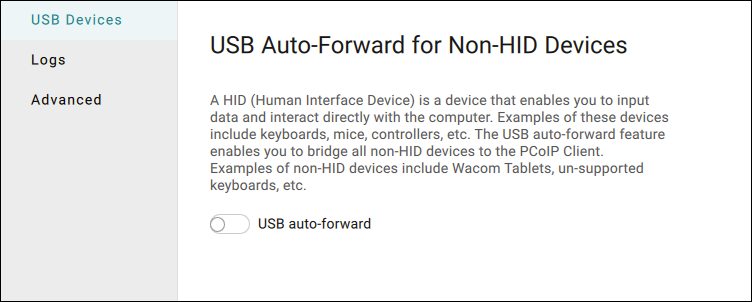

To enable automatic USB forwarding in the pre-session interface:
Disconnect any active PCoIP sessions and return to the pre-session interface.
Click the gear icon to open the settings window:
Click USB Devices in the left side menu, then enable USB auto-forward in the USB Auto-Forward for Non-HID Devices panel.
