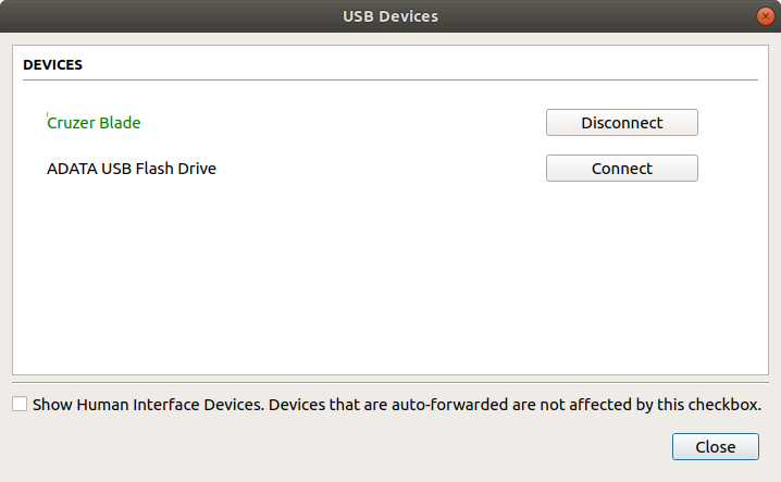

  1. Attach the USB device you want to connect to your local machine.
  2. Select Connection > USB Devices from the Anyware Software Client menu.
    A list of all USB devices connected to your client machine appears. The list includes both external devices you plug in and integrated devices such as laptop cameras.
    The name shown in the list is self-reported by the device; some devices will identify themselves only as USB Device.
    Important: Connecting special HID devices
    Because most Human Interface Devices (HIDs) are automatically processed by the Software Client for Linux, they do not appear on this list even if they use a USB connection. However, certain HID devices—like 3D mice and Wacom tablets—actually do require processing on the remote host, and will not work as expected unless connected to the session.
    To show these hidden HID devices and allow them to be connected, enable the Show Human Interface Devices checbox. You may also need to perform additional configuration steps or install drivers on the remote machine.
  3. Click Connect beside the USB device you want to use.

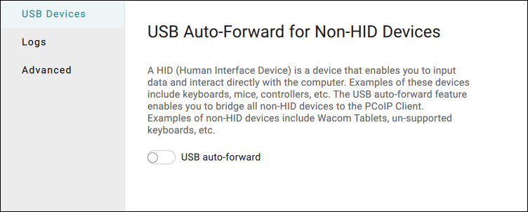

To enable automatic USB forwarding in the pre-session interface:
  1. Disconnect any active PCoIP sessions and return to the pre-session interface.
  2. Click the gear icon to open the settings window:
  3. Click USB Devices in the left side menu, then enable USB auto-forward in the USB Auto-Forward for Non-HID Devices panel.
