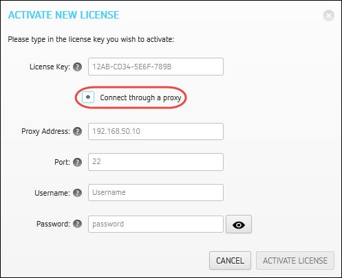

Before you can activate your license, you will need your activation key. If you are activating from behind a proxy, you will also need the IP address, port number, username, and password to authenticate to your proxy server. If you wish to use the virtual machine console to manage your licenses, see Using your Virtual Machine Console to Administer Licenses when Connected to the Internet
Using the UI to activate your PCoIP Management Console Enterprise license:
  1. Navigate to SETTINGS > LICENSE page.
  2. Select the NEW LICENSE button.
  3. Enter your License Key and select the ACTIVATE LICENSE button.
Using the UI to activate your PCoIP Management Console Enterprise license from behind a proxy server:
Activating your license from behind a proxy server requires you configure the additional parameters that appear after activating the Connect through a proxy option. The additional parameters are Proxy Address, Port, Username, and Password of the proxy server.
Activate New License Dialog
