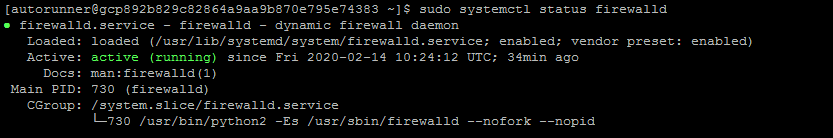

  14. Confirm the rules are applied.
    1. Check the firewalld status is active.
      sudo systemctl status firewalld

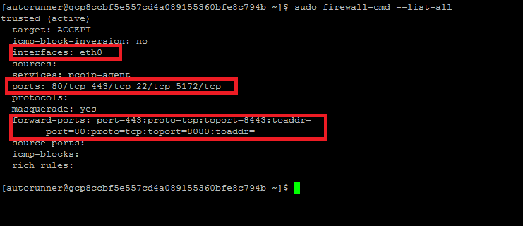

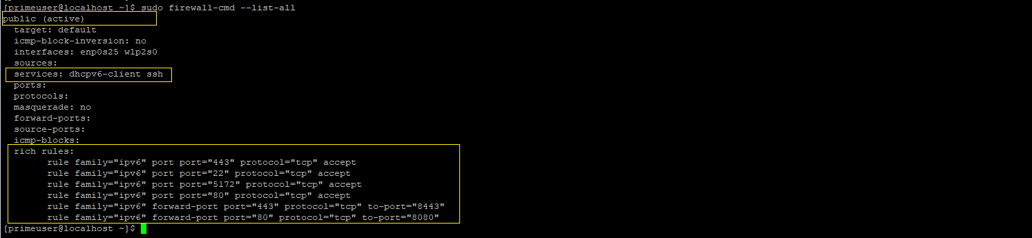

    2. Verify all rules are added in firewalld or not, all rules should be applied.
      sudo firewall-cmd --list-all
