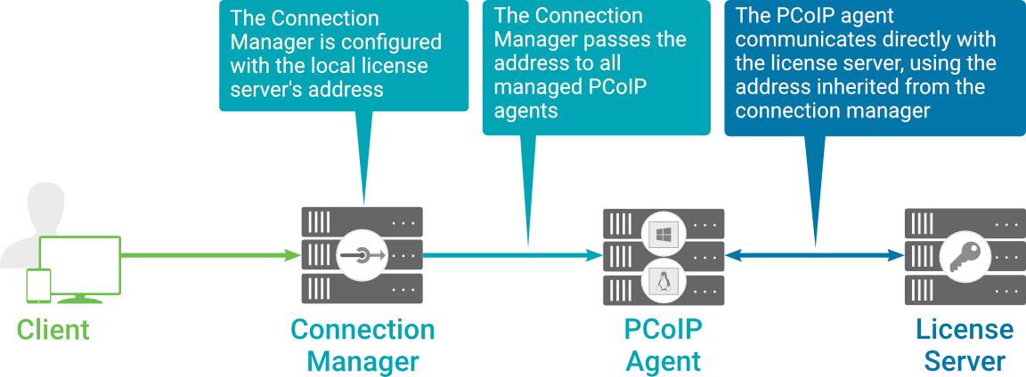

Brokered Environment Licensing
In brokered deployments, the license server address is configured in the Connection Manager, which passes it through to its managed PCoIP agents.
When using a Connection Manager, the license server address is only configured once no matter how many PCoIP agents are behind the Connection Manager.
To set the License Server URL in the Connection Manager:
  1. On the Connection Manager machine, use a text editor to open /etc/ConnectionManager.conf.
  2. Set the LicenseServerAddress parameter with the address of your local license server:
    • http://{license-server-address}:{port}/request
  3. Save and close the configuration file.
  4. Restart the Connection Manager.
