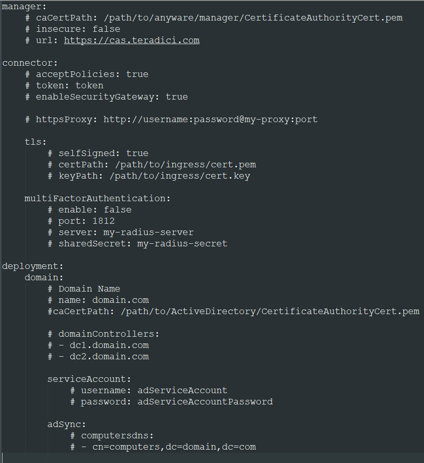

The following section outlines how to configure the Anyware Connector on RHEL/Rocky Linux using the configuration files that are downloaded as part of the Connector install. The Connector looks for two configuration files by default for configuration:
connector-secrets.yaml
connector-configuration.yaml
Both files can be found in the /etc/anyware-connector/ directory. These files will be generated in the default directory when you install the Connector RPM. The connector-configuration.yaml
file contains all of the installation configuration parameters that will persist after installation, the connector-secrets.yaml
file contains sensitive information and data, such as passwords, that will be reset after a successful installation for security considerations.

file or any custom configuration files so that they are not stored in plain text after installation. A sample configuration file is displayed below.
