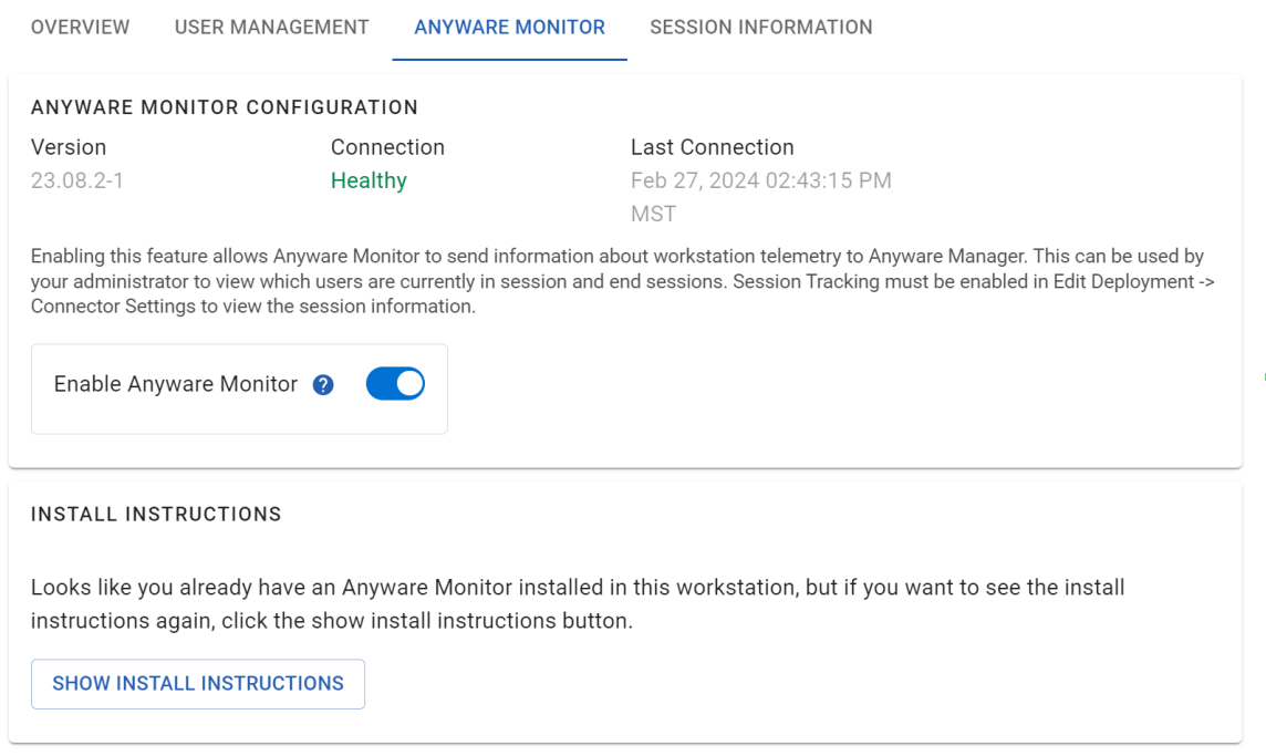

Workstation is unexpectedly marked as Unhealthy¶
There are multiple reasons why a monitor may go unhealthy:
The communication channel between the monitor and Anyware Manager may have issues.•System clocks between Monitors and Anyware Manager must be the same.
The configurations of Monitor may not be correct.
The Registration status of the Monitor may not be correct or complete.See the Troubleshooting Tool section for help in diagnosing these issues.

Ensure system clocks are synced
The Anyware Monitor health status, displayed in the Anyware Manager, relies on regular time-stamped messages coming from the Monitor. If the system clocks are off by more than a minute, the Manager may report that the Monitor status is unknown. To prevent this, ensure both the Monitor and Manager system clocks are in sync.

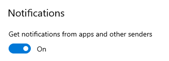

Enabling notifications on Windows 10 and 11¶
You can enable notifications by performing the following steps:
Navigate to Start menu and click Settings.
Click the System tab and select Notifications & actions.
Enable the Notifications toggle.
You can also enable notifications by editing Windows Registration using a PowerShell Command and restarting the workstation.
