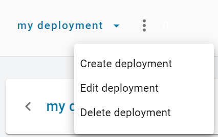

In Anyware Manager, click Edit deployment from the kebab option to edit your deployment to provide the trusted Root Certificate to the Intel® AMT Provider Service Account

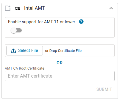

Under Provider Service Accounts open the Intel® AMT account box.
Click Select File, browse and upload a Root Certificate public key file in the
.pem
format from your system. You can also copy and paste contents from the Root Certificate public key file to the AMT CA Root Certificate section. -

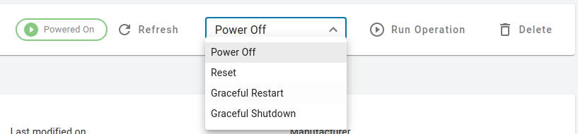

Once the workstations are added and the Intel® AMT configuration is completed, you can manage power operations for each workstation in the Workstations or Workstations Pools page:
- Open a desired workstation.
The current available power operations are shown in the drop-down menu. To change the power state, select the desired operation from the drop-down menu and click Run Operation.
- Available remote power operations are:
- Power On
- Power Off
- Graceful Shutdown
- Reset
- Graceful Restart

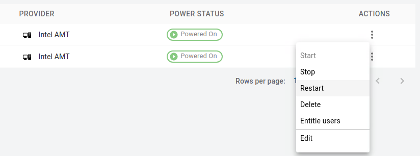

You can also execute power operations on a single workstation or on multiple workstations from the Workstations or Workstations Pools page:
Under the ACTIONS section, click the kebab option to select the desired power operation.
- Start (Power On)
- Stop (Power Off)
- Restart (Reset)
