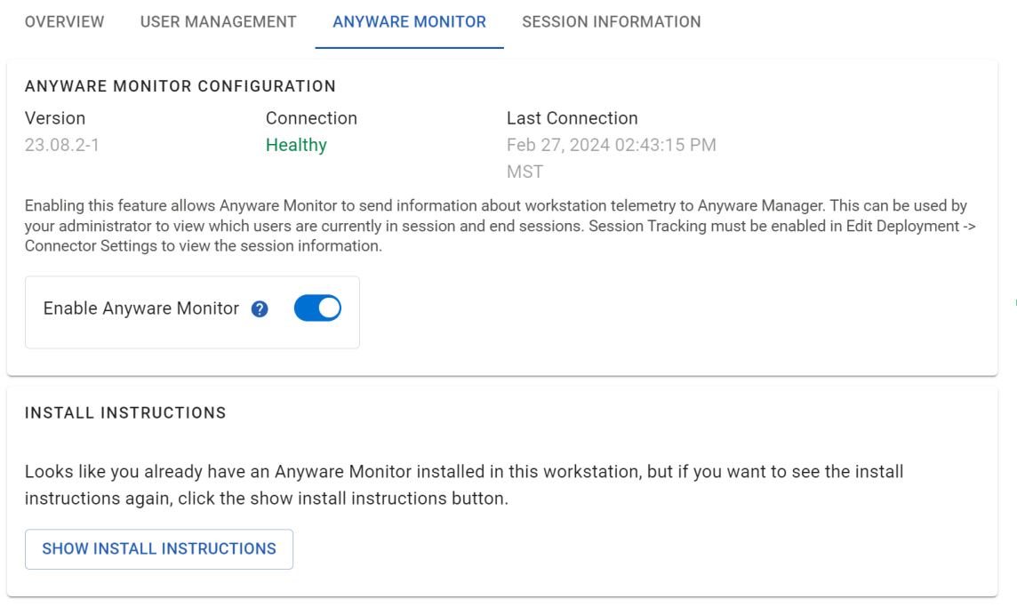

If the registration fails and the token is more than one hour old, generate a new script command with a refreshed token by navigating to the Workstation's Anyware Monitor tab and select Show Install Instructions for a refreshed command and try again.

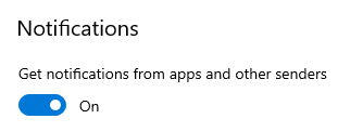

Enabling notifications on Windows 10 and 11¶
You can enable notifications by performing the following steps:
Navigate to Start menu and click Settings.
Click the System tab and select Notifications & actions.
Enable the Notifications toggle.
You can also enable notifications by editing Windows Registration using a PowerShell Command and restarting the workstation.
Run the following command:
Set-ItemProperty -Path "HKCU:\Software\Microsoft\Windows\CurrentVersion\PushNotifications" -Name "ToastEnabled" -Type DWord -Value 1
These actions only enable notifications for the current user. This can be further automated to apply the setting for multiple users.

After Adding or Linking the machine, the machine does not show as Healthy after some time
- The Monitor tries to proceed with registration when you choose the ADD or LINK option for a machine during installation. If there is a temporary network issue, the message may not be received or there may be an issue with registration. To help determine root cause, inspect the Monitor logs. For more information, see Anyware Monitor Logs.
