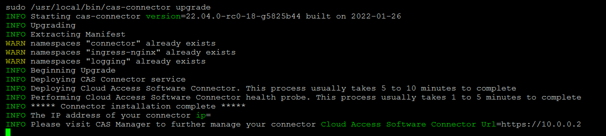

  2. Run the following command to upgrade the Connector with the current configuration:
    sudo /usr/local/bin/anyware-connector upgrade
Once you have successfully upgraded the Connector you should see a response similar to the example output outlined below. Anyware Connector Update Termical
