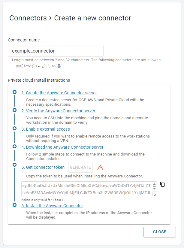

4. Generating a Connector Token¶
You must generate a Connector token using the Admin Console. The steps outlined below must be performed on the target virtual machine.
You need to create or have created a deployment prior to obtaining a token. For information on how to log into the Admin Console, see Admin Console Connection. The following section outlines how to obtain a Connector token using the Admin Console:
- Click Connectors from the console sidebar.
- Click the add connector button (+ sign located beside Connectors heading) to display the connector creation panel.
- Enter the following information:
- Select the deployment you want to add the Connector to. If you do not have an existing deployment you need to create one.
- Enter the name of the Connector.
- Follow the step by step instructions outlined below.
- Click GENERATE.
- Copy the Connector token by click the copy icon.
You can now use this Connector token when prompted during installation.
