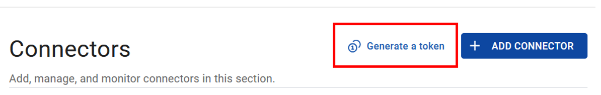

Click Connectors from the console sidebar.
Click the Generate a token button next to the + ADD CONNECTOR button.

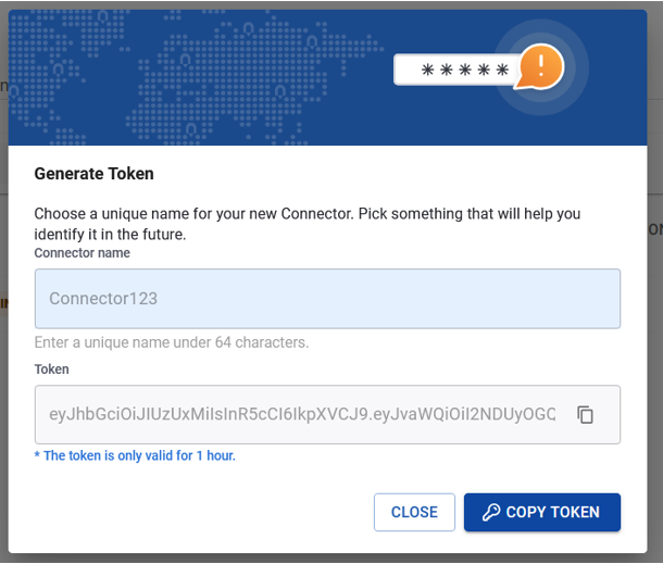

In the pop-up form, enter the Connector name.
Click the COPY TOKEN button to proceed with the Connector installation. You will see a new row for the specified Connector name added to the Connectors table, marked with a PENDING INSTALL status. Once the installation begins, you can track the progress in the Admin Console.

-t, --token | connector.token |
String | Required. The token generated from Anyware Manager for Connector to create a service account to connect to Anyware Manager. |
--accept-policies | connector.AcceptPolicies |
