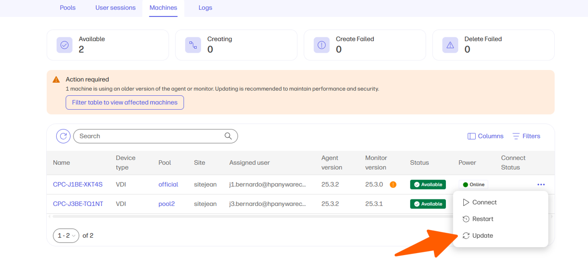

Updating Agents and Monitors from the Machines Tab
If your agent version is outdated, a warning icon appears next to the machine in the machines list. The Update option in the action list is used to trigger agent updates remotely.
If there is an active session on the machine, you will be prompted to save your work. The update will start in a few minutes.
Info
Anyware agents and Anyware Monitors must be on version 25.03 or later.
Procedure
  1. Sign in to Anyware Manager Enterprise.
  2. Click the tenant for which you want to operate machines, and click the Machines tab.
  3. Look for an alert message at the top of the tenant detail page indicating that updates are required on machines.
  4. Click Filter table to view affected machines in the alert message. The machine list will be filtered, and only machines that require updates will be displayed.
  5. Select the machine you want to update:
    • Use the funnel icon in the top-right corner to filter the machines by status or device type.
    • Use the search bar to provide tags, attributes, and keywords to narrow down the list of machines.
  6. Look for an alert symbol in the Agent version or the Monitor version column. The alert symbol indicates that an update is available for the agent or the monitor.
  7. Click the alert to reveal an action menu.
  8. Click Update.
    Update agent
This will initiate an update of the agent installed on the machine. If the update is successful, the alert symbol will disappear.
