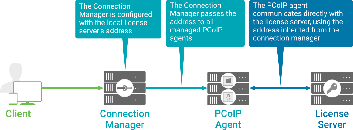

Brokered Environment Licensing
In brokered deployments, the license server address is configured in the Connection Manager, which passes it through to its managed PCoIP agents.
Brokered Licensing Flow Local license validation using a Remote Workstation Card Agent for Linux and a brokered connection
When using a Connection Manager, the license server address is only configured once no matter how many PCoIP agents are behind the Connection Manager.

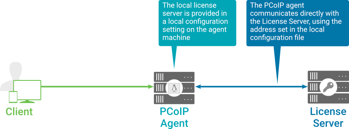

Unbrokered Environment Licensing
In direct, or unbrokered, deployments, each PCoIP agent is configured with the license server address via a local agent setting. When a client initiates a new PCoIP session, the PCoIP agent uses its local configuration to communicate with the license server.
Direct Licensing Flow Local license validation using a Remote Workstation Card Agent for Linux and a direct (unbrokered) connection
Each PCoIP agent in your environment must be individually configured with the license server's URL.
