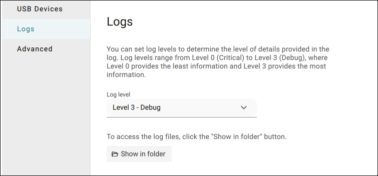

Setting the Log Level in the Pre-session Interface
  1. Disconnect active PCoIP sessions and return to the pre-session interface.
  2. Click the gear icon in the top-left corner to open the Anyware | Settings window.
  3. Click Logs in the left pane.
  4. Under Log level, specify the desired log level.
    Set client log level
