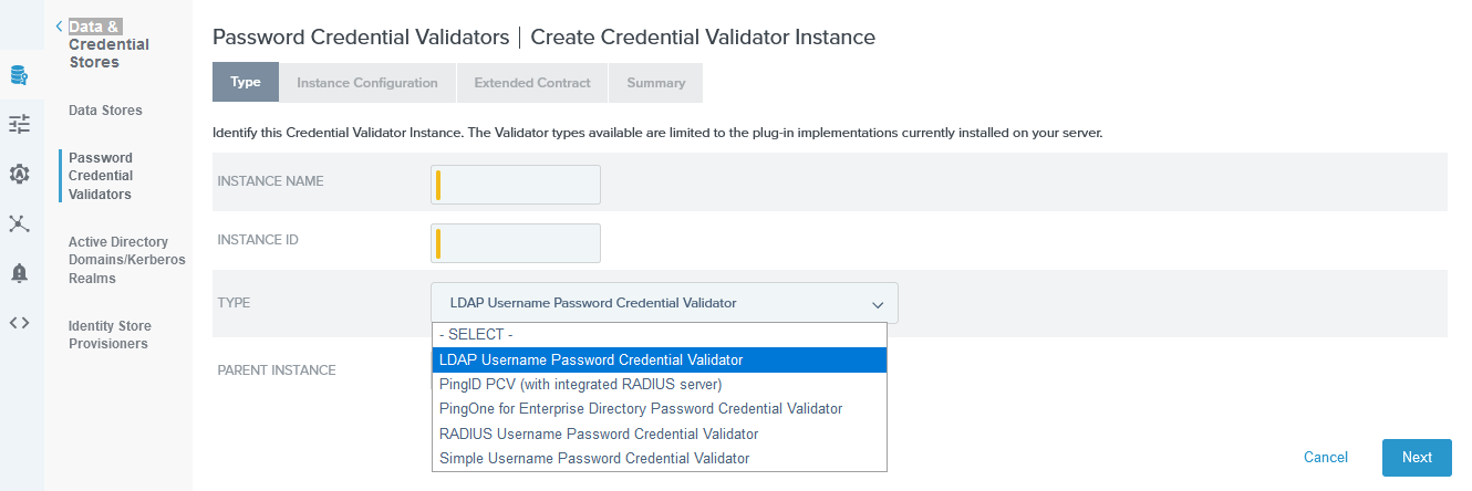

  3. Select password credential validator type as LDAP Username Password Credential Validator and fill required fields to configure an AD Datastore.
    1. Enter the INSTANCE NAME, INSTANCE ID and select LDAP Username Password Credential Validator for TYPE and click on Next.
    Password Credential Validator Type
