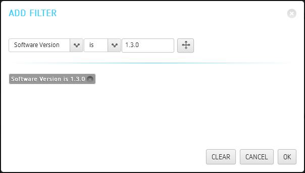

If you have an endpoint in recovery mode, make a note of its firmware version number. You can then locate all endpoints in recovery mode from the PCoIP Management Console ENDPOINTS page by creating a filter to display endpoints running this firmware version.
The following example creates a filter for firmware version earlier than 5.0.0.
Filter criterion for finding endpoints in recovery mode
