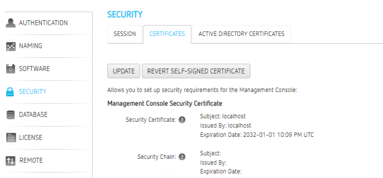

New default self-signed certificate
Management Console began using a new default self-signed certificate as of 23.08. Certificate details can be verified in SETTINGS > SECURITY under CERTIFICATES.
Self-signed certificate details
