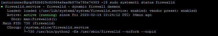

    1. Check the firewalld status is active.
      sudo systemctl status firewalld
      Firewalld Active Status

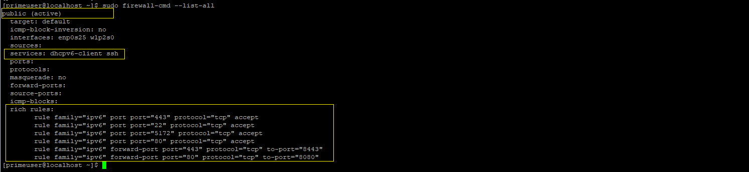

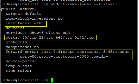

    2. Verify all rules are added in firewalld or not, all rules should be applied.
      sudo firewall-cmd --list-all
      Firewalld Listed Rules
