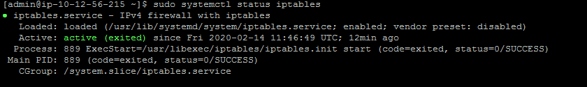

  2. Check iptables status(which should be active).
    sudo systemctl status iptables
    Iptables Status

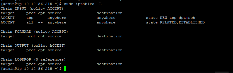

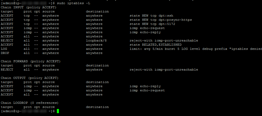

  3. Check the applied iptables rules.
    sudo iptables -L
    Iptables Rules

  15. Check iptables rules (should not contain rules which Management Console install previously added).
    sudo iptables -L
    Check iptables Rules

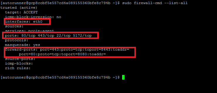

  32. Confirm the rules are applied.
    1. Check the firewalld status is active.
      sudo systemctl status firewalld
      Firewalld Active Status
    2. Verify all rules are added in firewalld, all rules should be applied.
      sudo firewall-cmd --list-all
      Firewalld Listed Rules
