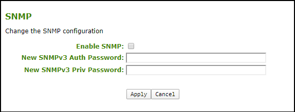

From the AWI SNMP page, you can enable or disable the device’s SNMP agent.
AWI SNMP Page
AWI SNMP page
To configure SNMPv3 perform the following steps:
  1. From the AWI, select Configuration > SNMP.
  2. Select Enable SNMP check box.
    When enabled, the device enables the PCoIP SNMP agent to respond to SNMP requests. Disabling the SNMP agent prevents it from responding to SNMP requests and from generating traps. It also ensures that the PCoIP SNMP MIB cannot be accessed.
  3. For SNMPv3 Auth Password, enter an 8 - 16 character password to identify the agent with the manager.
  4. For SNMPv3 Priv Password, enter an 8 - 16 character password to activate encryption of the data stream with the manager.
  5. Click Apply.
