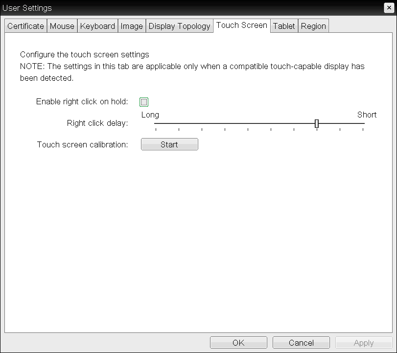

The OSD Touch Screen page, as shown next, enables you configure and calibrate settings for an attached Elo TouchSystems touch screen display.

The following parameters display on the OSD Touch Screen page.
OSD Touch Screen Parameters
Parameter | Description |
Enable right click on hold | Select this check box to let users generate a right-click when they touch the screen and hold it for a few seconds. If disabled, right-clicking is not supported. |
Right click delay | Slide the pointer to the position (between Long and Short) to determine how long the users must touch and hold the screen to generate a right-click. |
Touch screen calibration | When you first connect the touch screen to the Tera2 PCoIP Zero Client, the calibration program starts. At the touch screen, touch each of the three targets as they appear. To test the calibration, run your finger along the monitor and ensure that the cursor follows it. If it is not successful, the calibration program automatically restarts. Once calibrated, the coordinates are stored in flash. To manually start the calibration program, from the OSD Touch Screen page, click Start. Follow the onscreen prompts. |

- From the OSD, select Options > User Settings > Touch Screen.
- From the OSD Touch Screen page, update the touch screen settings.
- Click OK.
