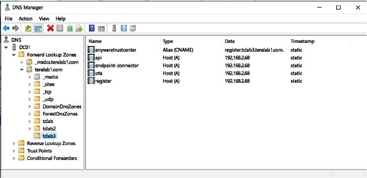

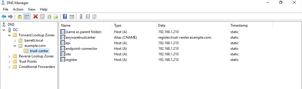

Important: Supporting automatic Anyware Trust Center discovery
If you plan to support automatic Anyware Trust Center discovery by endpoints, you must also create a CNAME record that redirects anywaretrustcenter to register.<domain-name>.
Example: using trust-center.example.com
Using trust-center.example.com as the base domain, you would create DNS records for the following:
  • trust-center.example.com
  • api.trust-center.example.com
  • endpoint-connector.trust-center.example.com
  • ota.trust-center.example.com
  • register.trust-center.example.com
This example shows a different DNS configuration using Windows DNS Manager:
DNS Manager Example

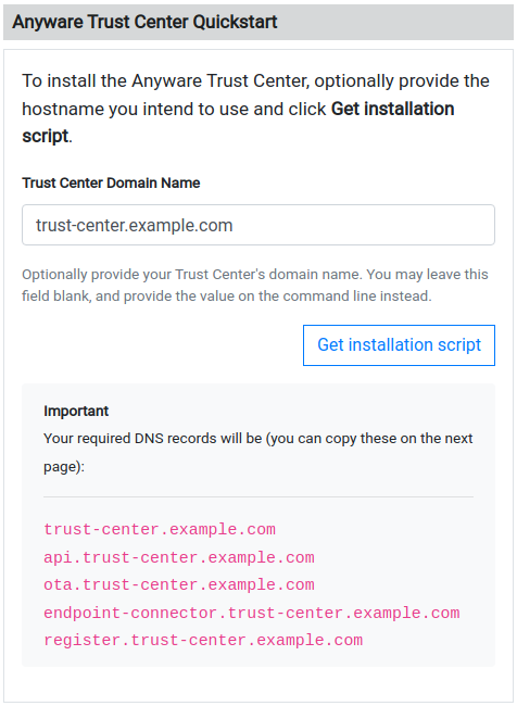

To download the Anyware Trust Center installer, you must have an account on our support site (https://help.teradici.com). You can create one from the login screen if you don't already have one.
To download the installer:
  1. Go to https://anyware.hp.com/find/product/anyware-trusted-endpoints/2024.07/anyware-trust-center.
  2. If you are not already logged in, click Log in to download and authenticate your session.
  3. Click Downloads and scripts:
    Downloads and Script button
  4. Read and accept the End User License Agreement. Once the agreement has been accepted, the download form is shown:
    Download form pre-submit
  5. Provide your chosen FQDN—recorded earlier—in the Trust Center Hostname (FQDN) field, and click Get installation script.
    Note: FQDN field is optional
    The FQDN value is required to run the installer, but you do not have to supply it here. If you leave this field blank, you must manually add the actual FQDN to the script command before executing it.

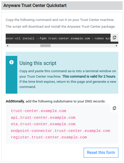

  6. The website will generate a download command and display it:
    Download form post-submit
    Copy the entire command displayed. There are two parts, and both are required: a curl command that downloads the installation script, and second command that executes the script.
    The installation script command looks like this:
    curl -sSL https://dl.anyware.hp.com/{token}/trust-center/raw/names/trust-center-tgz/versions/{version}/trust-center_{version}.tar.gz | tar -xz && sudo ./trust-center-ctl install --fqdn {trust-center-FQDN} --token {jwt token}
    Important: This script is time-limited
    The generated command is valid for 1 hour, after which installation will fail. If that occurs, return to the download page and generate a new command.

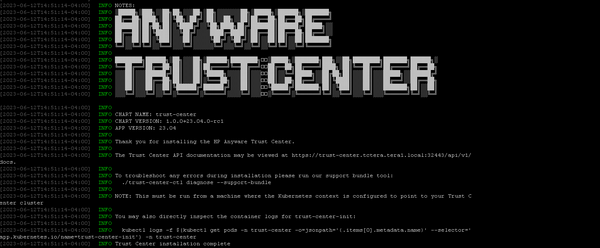

    After installation completes, you will see a message similar to this:
    Alt text
  3. To validate the installation, run the following command:
    sudo ./trust-center-ctl diagnose
    All services should report healthy.
