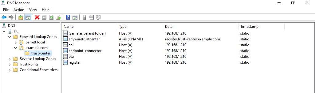

This example shows a different DNS configuration using Windows DNS Manager:
DNS Manager Example
