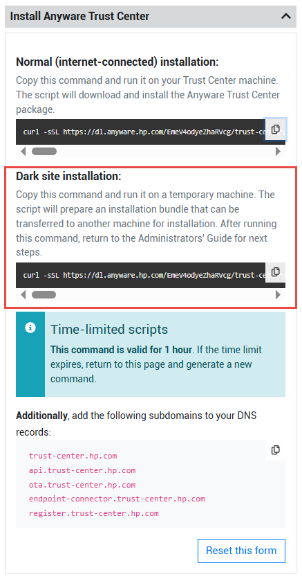

  6. Under Install Anyware Trust Center, copy the entire command displayed. There are two parts, and both are required: a curl command that downloads the installation script, and second command that executes the script.
    Download command
    Important: This script is time-limited
    The generated command is valid for 1 hour. If the token expires before you run it, return to the download page and generate a new command. The time limit applies to running the prepare command, not installing the package. Once you have successfully generated the installation bundle, you can install the package at any time.

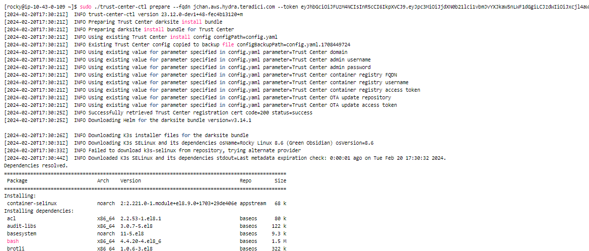

  7. Paste the command copied earlier and run it to prepare a Trust Center Darksite bundle for installation. The --save-path flag in the command is optional.
Once the operation completes, you should see 2 files in the current directory (or in the path specified by --save-path):
- anyware-trust-center-bundle.tar.gz
- anyware-trust-center-bundle.sha
Sample output of TC Prepare Command
TC Prepare

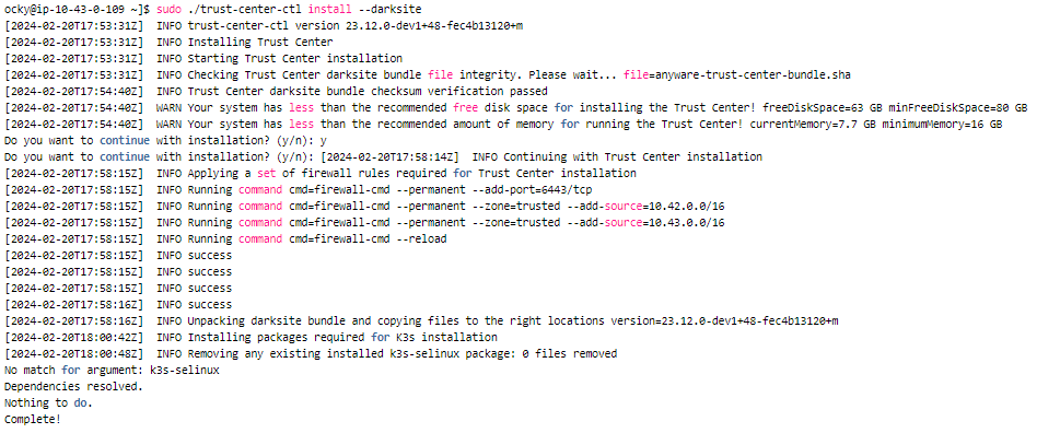

  2. Open a terminal window and navigate to your installation directory (the location you used when you copied the installation files). Run the following command:
    sudo ./trust-center-ctl install darksite --admin-password <desired Trust Center admin password>
    The command installs a new Darksite Trust Center.

Sample output of Trust Center Darksite install:
Darksite install
