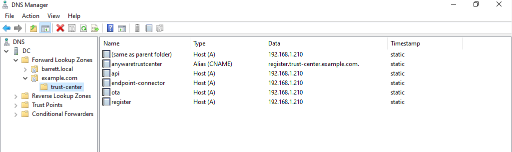

This example shows a different DNS configuration using Windows DNS Manager:
DNS Manager Example

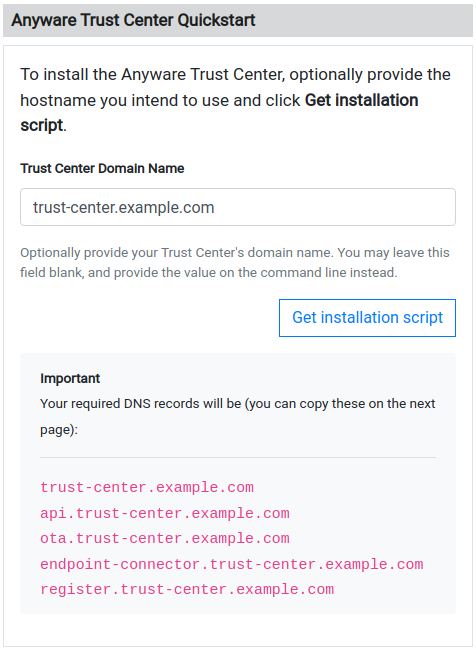

  5. Provide your chosen FQDN—recorded earlier—in the Trust Center Hostname (FQDN) field, and click Get installation script.
    Note: FQDN field is optional
    The FQDN value is required to run the installer, but you do not have to supply it here. If you leave this field blank, you must manually add the actual FQDN to the script command before executing it.

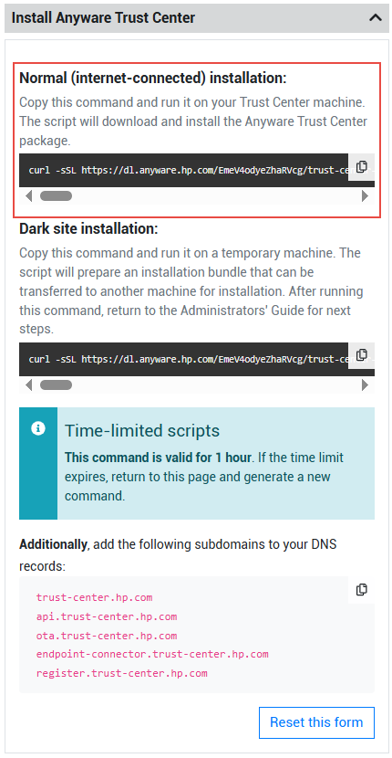

    The website will generate a download command and display it:
    Download command
  6. Copy the entire command displayed under Normal (internet-connected) installation. There are two parts, and both are required: a curl command that downloads the installation script, and second command that executes the script.
    Important: This script is time-limited
    The generated command is valid for 1 hour, after which installation will fail. If that occurs, return to the download page and generate a new command.

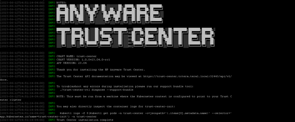

    After installation completes, you will see a message similar to this:
    Alt text

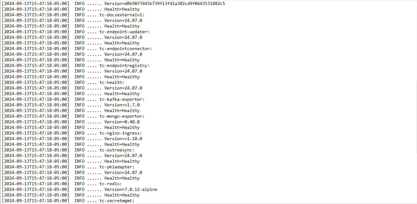

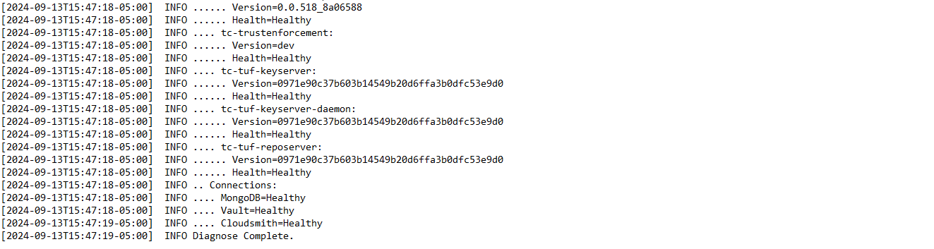

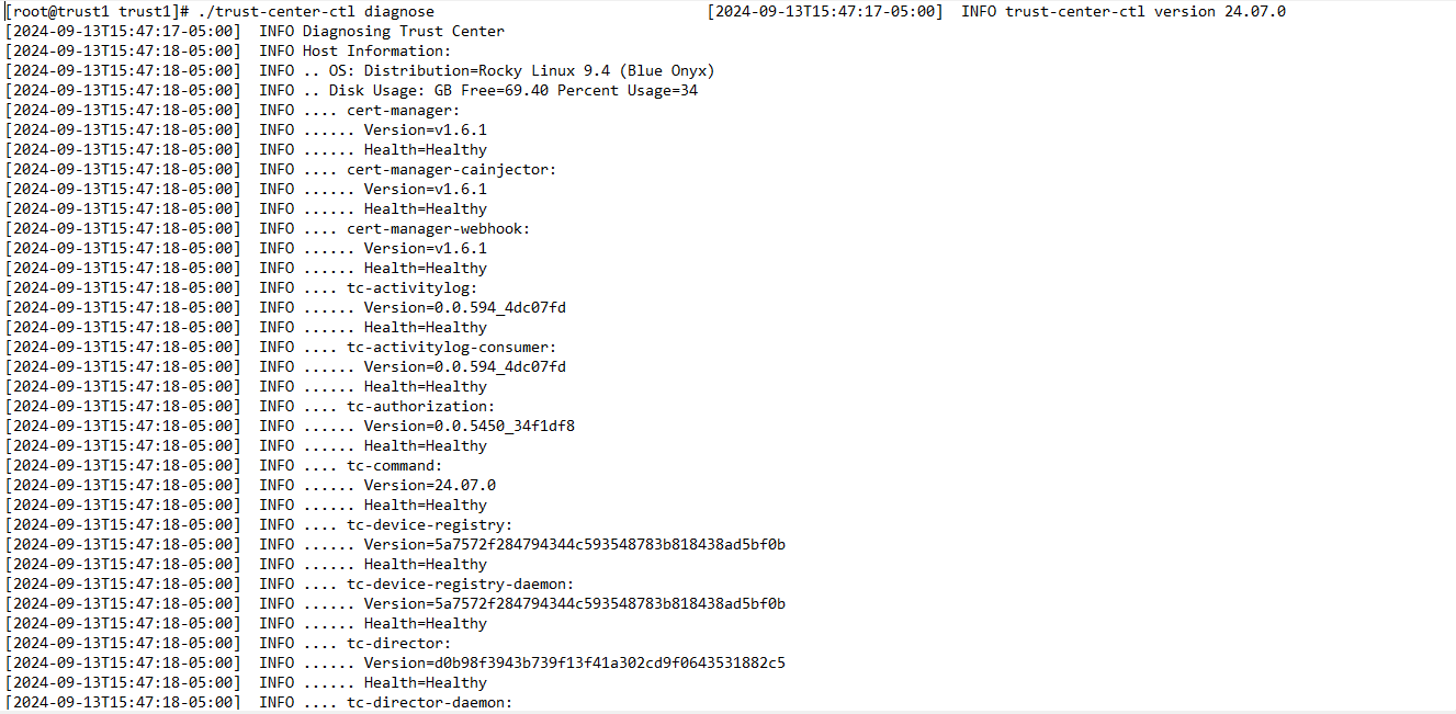

  3. To validate the installation, run the following command:
    sudo ./trust-center-ctl diagnose
    All services should report healthy.
If the diagnostic process finds that the installation completed successfully, you will see log output as shown below, where all service information is indicated as "Health=Healthy". You will not see any "error" in the log.
image one image two image three

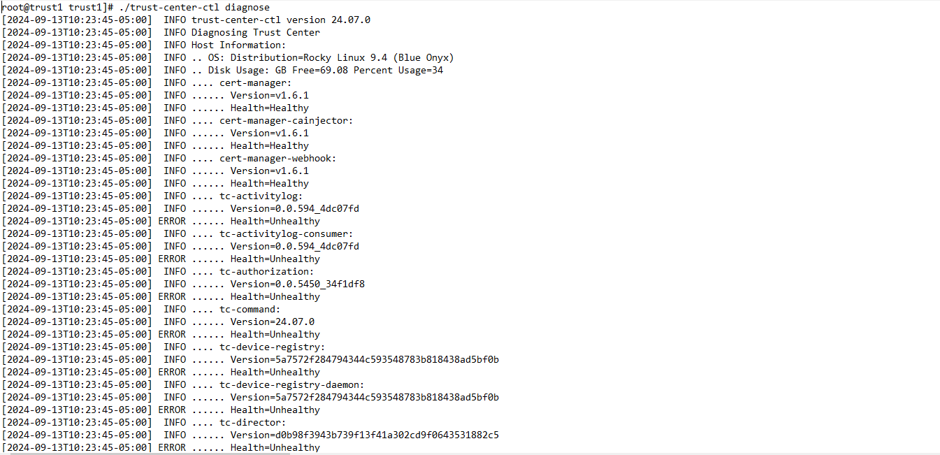

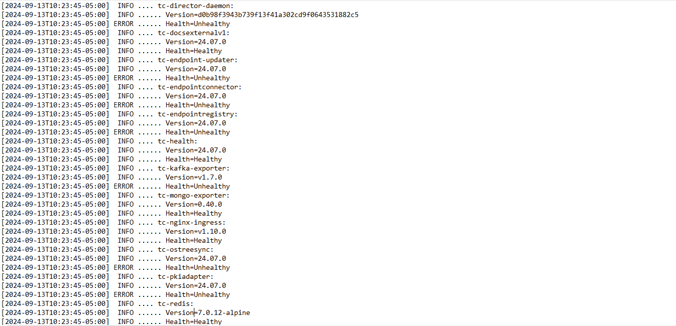

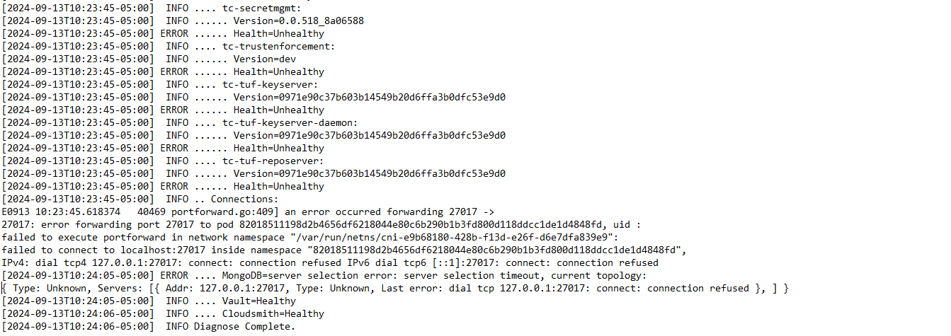

If the diagnostic process finds that the installation did not complete successfully, you will see log output as shown below, where one or more services indicate an error with "ERROR ...... Health=Unhealthy".
The Trust Center may be unhealthy for the following reasons:
  • Some databases used in the Trust Center are not compatible with Sparse (thin) Virtual Disks. This incompatibility can lead to installation failures without clear error messages. If you encounter an installation failure and are using Sparse Disk Images, switch to Thick Disk Provisioning.
  • The firewall may be blocking k3s functionality. If this is the case, disable any firewall rules that could be obstructing k3s local network communications.
