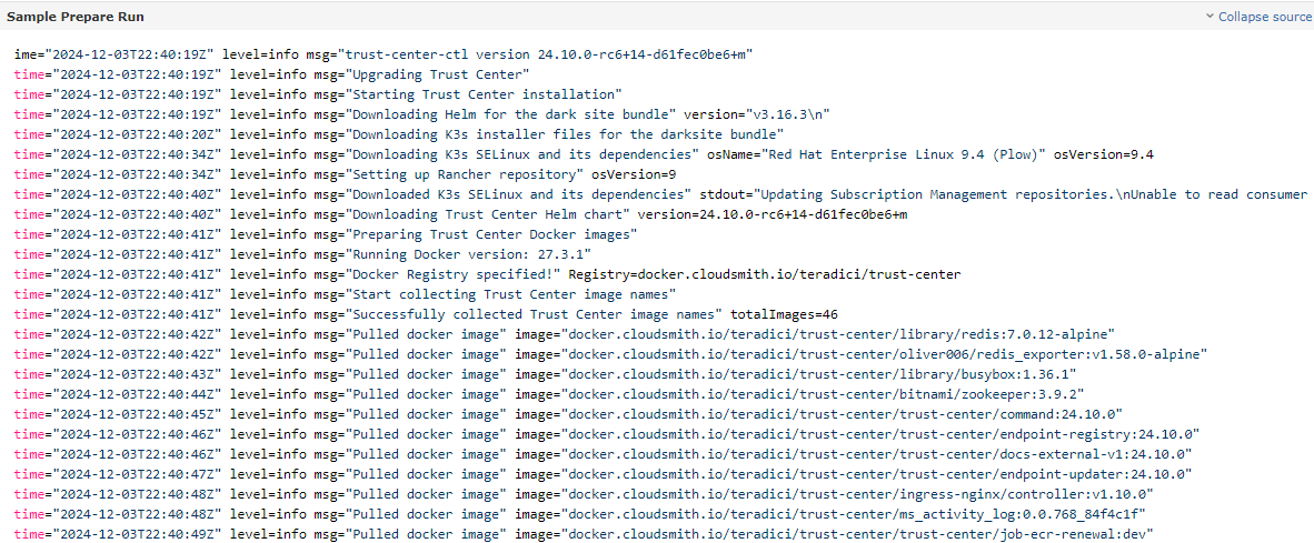

  7. Paste the command copied earlier and run it to prepare a Trust Center Darksite bundle for upgrade.
    Example output of running TC Prepare command:
    TC preparation output

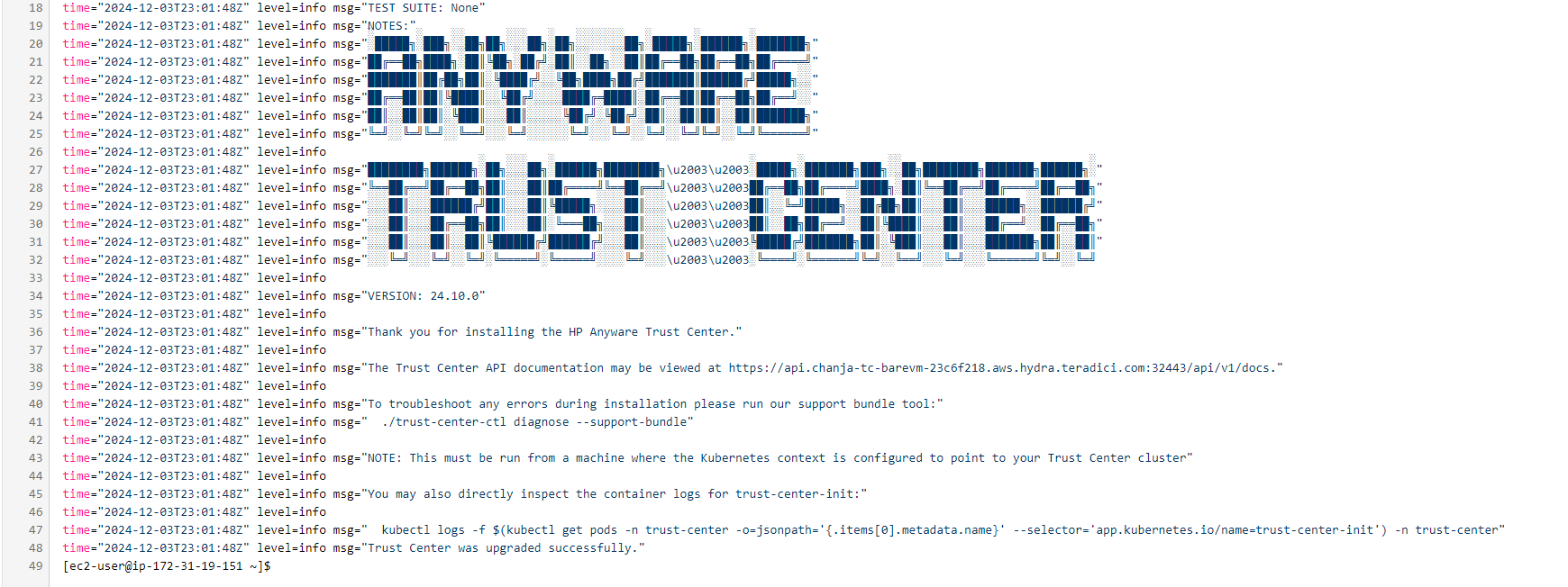

    Example output of running a Darksite Upgrade command:
    TC upgrade output
