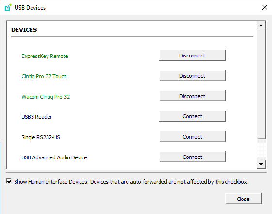

Connecting Cintiq Pro 32 Tablets¶
The Wacom Cintiq Pro 32 appears as three separate devices in the USB menu. You must connect all three USB devices to use this tablet:
- ExpressKey Remote
- Cintiq Pro 32 Touch
- Wacom Cintiq Pro 32

Connecting a Wacom Tablet¶
To use the Wacom tablet, you must manually connect it to the remote session. Wacom tablets that are not connected will appear to the remote host as a mouse, resulting in a confusing situation where the tablet appears to work but only acts as a pointer.
