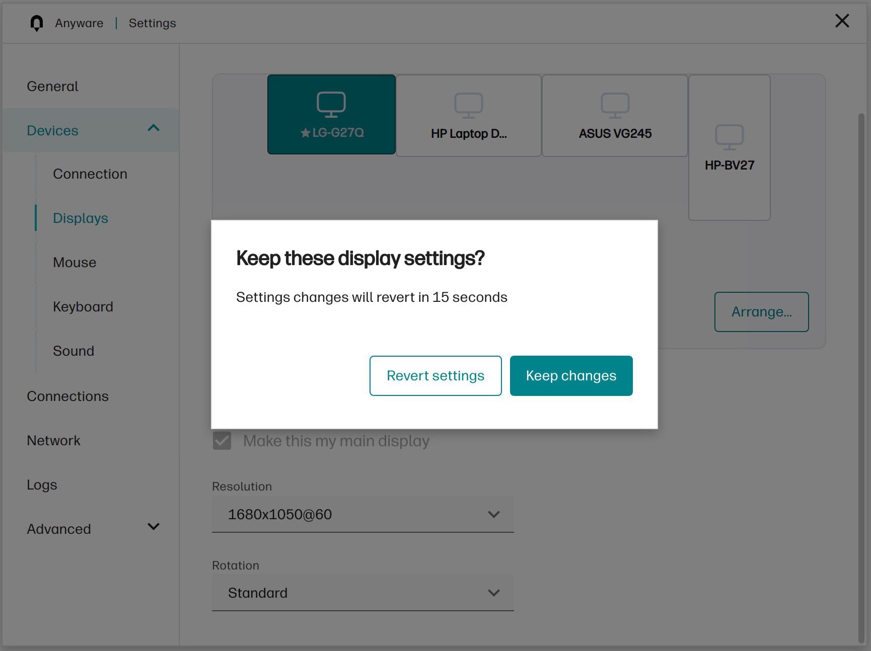

Arrange Displays Settings > Devices > Display > Arrange Click the Arrange button, and drag-and-drop your monitors to position them to match your physical layout.
Edit Display Settings Settings > Devices > Display Select a display to modify it. You can set each display's orientation and resolution, and set one monitor as the desktop's primary display.
  • Confirm Changes: In the display settings modal dialog, click the Keep changes button to apply your adjustments.
  • Revert to Original Settings: If you prefer to return to the original settings, click the Revert settings button Display confirmation button
Note: User Interaction Timeout
A timeout of 20 seconds is set for you to interact with the modal dialog. If you do not interact with the modal before the timeout expires, any changes will be reverted.

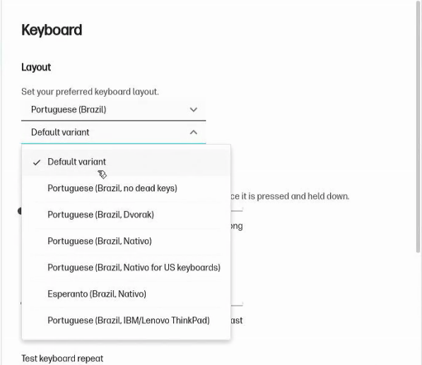

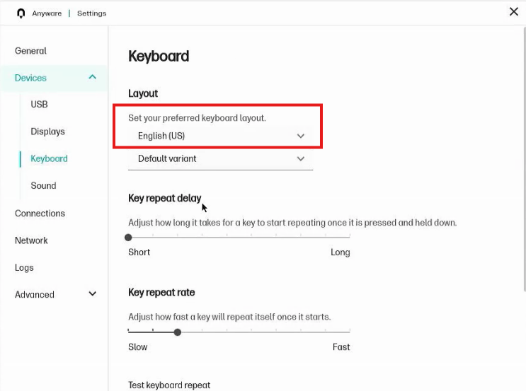

Keyboard Layout Settings > Devices > Keyboard Select your preferred keyboard layout from the dropdown menu. The system applies the new layout immediately. Key Board Layout

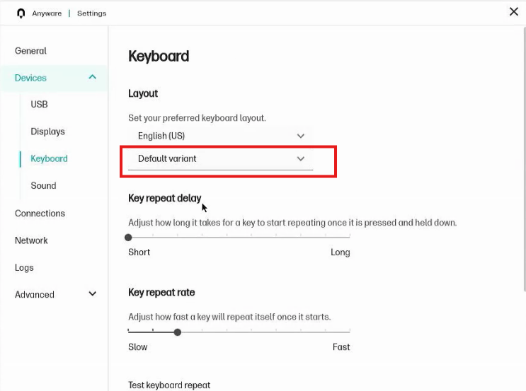

Keyboard Layout Variant Settings > Devices > Keyboard Select a variant that matches your regional or personal preferences to ensure special characters and symbols are positioned as expected. Keyboard Layout Variant
Keyboard Layout Variant List

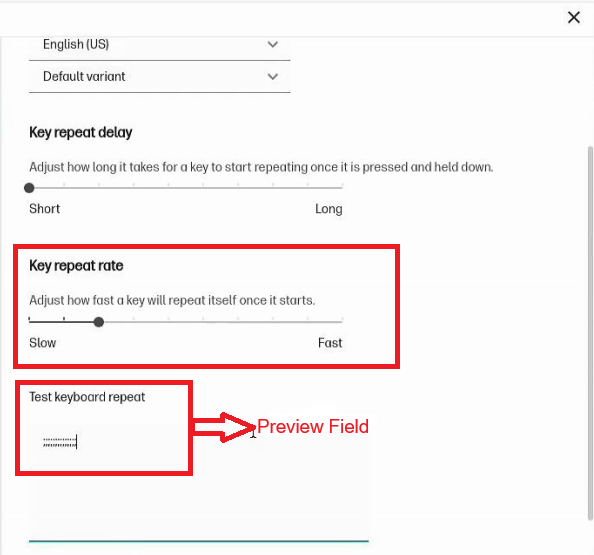

Keyboard Repeat Rate Settings > Devices > Keyboard Adjust the slider to increase or decrease the repeat rate. Use the preview field to test the setting after you apply the changes. Keyboard Repeat Rate

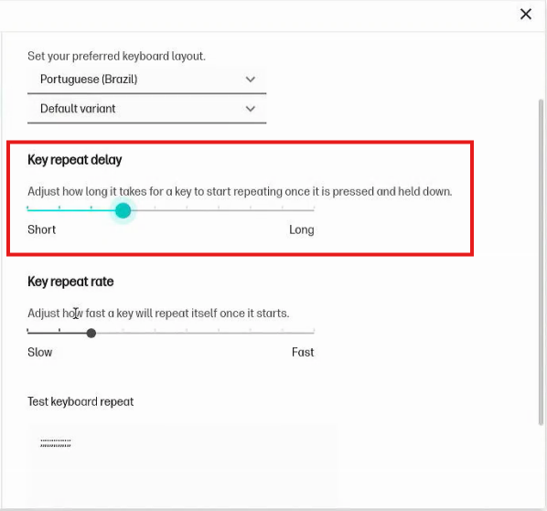

Keyboard Repeat Delay Settings > Devices > Keyboard Use the slider to set a shorter or longer delay. A shorter delay starts repeating characters sooner. A longer delay gives you more time before repetition begins. Keyboard Repeat Delay
