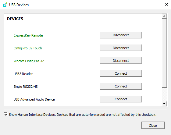

Connecting Cintiq Pro 32 Tablets¶
The Wacom Cintiq Pro 32 appears as three separate devices in the USB menu. You must connect all three USB devices to use this tablet:
- ExpressKey Remote
- Cintiq Pro 32 Touch
- Wacom Cintiq Pro 32
