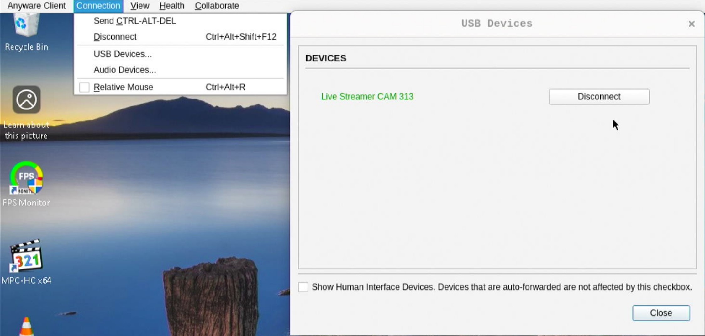

  1. Attach the USB device you want to connect to your Trusted Zero Client.
  2. Reveal the Trusted Zero Client's menu bar by moving the mouse cursor to the top of a display.
  3. From the menu bar, select Connection > USB Devices.
    A list of all USB devices connected to your Trusted Zero Client appears. The name shown in the list is self-reported by the device; some devices will identify themselves only as USB Device.
    Important: Connecting special HID devices
    Because most HID devices are automatically processed by the Trusted Zero Client, they do not appear on this list even if they use a USB connection. However, certain HID devices—like Wacom tablets—actually do require processing on the remote host, and will not work as expected unless connected to the session.
    To show these hidden HID devices and allow them to be connected, enable the Show Human Interface Devices checbox. You may also need to perform additional configuration steps or install drivers on the remote machine.
  4. Click the Connect button.
