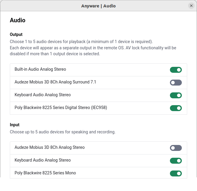

  1. When in session, go to the Connection dropdown menu, and click Audio.
    The Audio dialog will pop up as follows:
    Multiple Audio Device
  2. On the Anyware | Audio window, select the output devices:
  3. Under Output, use the toggle buttons next to the output devices to select the devices of your interest. The Trusted Zero Client selects a default output device, for which the toggle button appears locked until you select another device.
  4. Select another audio output device by using the toggle button next to the audio device. 3 output devices can be selected at a time.
  5. Under Input, use the toggle buttons next to the available input devices to select the input device of your interest. 3 input devices can be selected at a time.
  6. Wait until the devices have been selected.
Once selected, the audio devices are forwarded to the agent.
