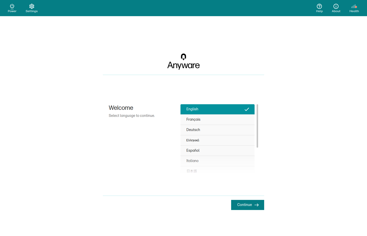

Set Your Interface Language
Choose the language you prefer for the client's pre-session as well as in-session interface.
The following languages are supported:
  • Chinese Simplified
  • English
  • French
  • German
  • Italian
  • Japanese
  • Korean
  • Portuguese (Iberian)
  • Spanish
This setting controls most of the dialog and menu text that you see before connecting to a remote desktop. It does not affect the remote desktop language.

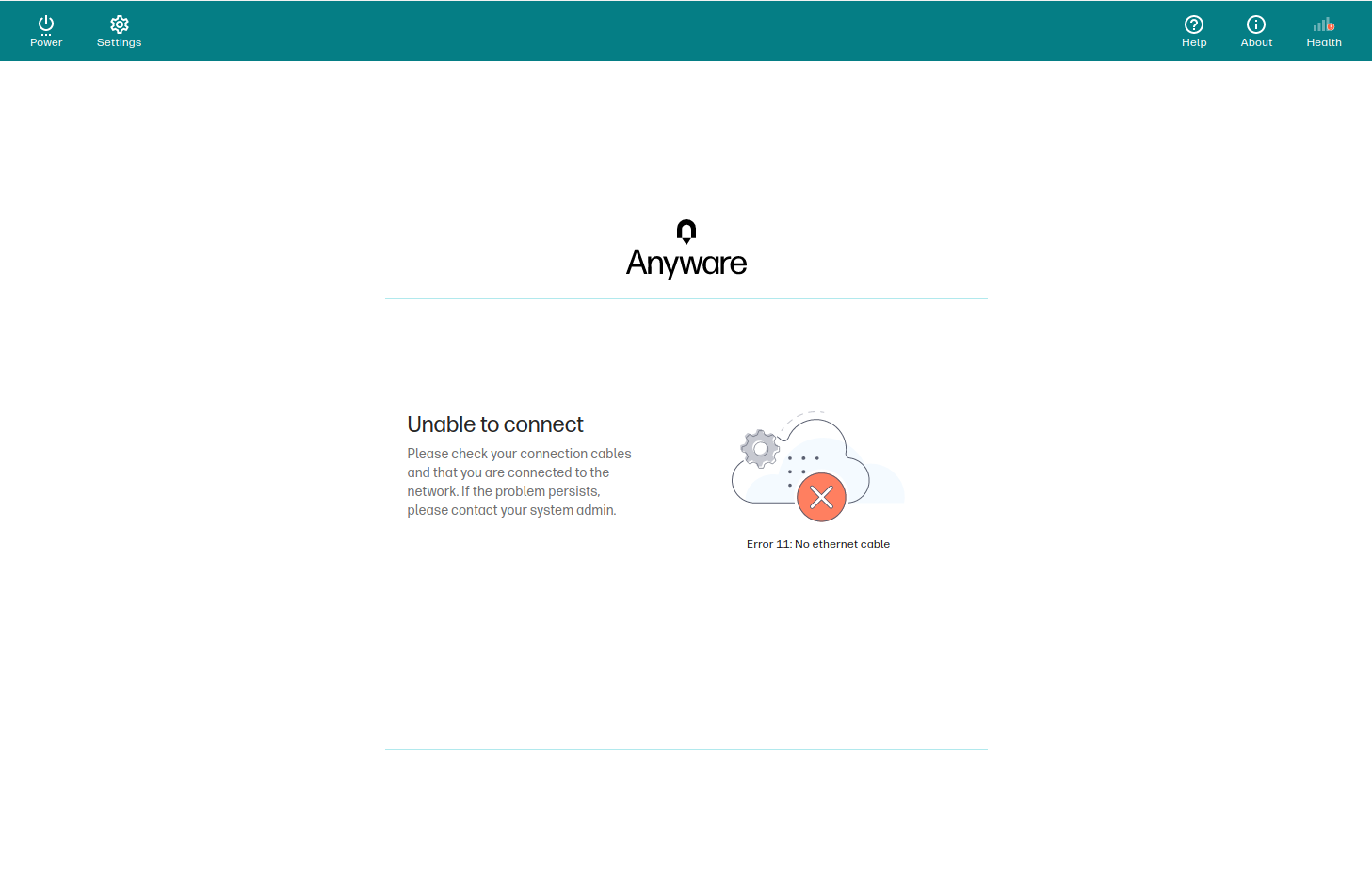

Validate Network Settings
After setting the language, the Trusted Zero Client will validate your network settings. If there is a problem with your network connectivity, you will see an error similar to this:
Network error

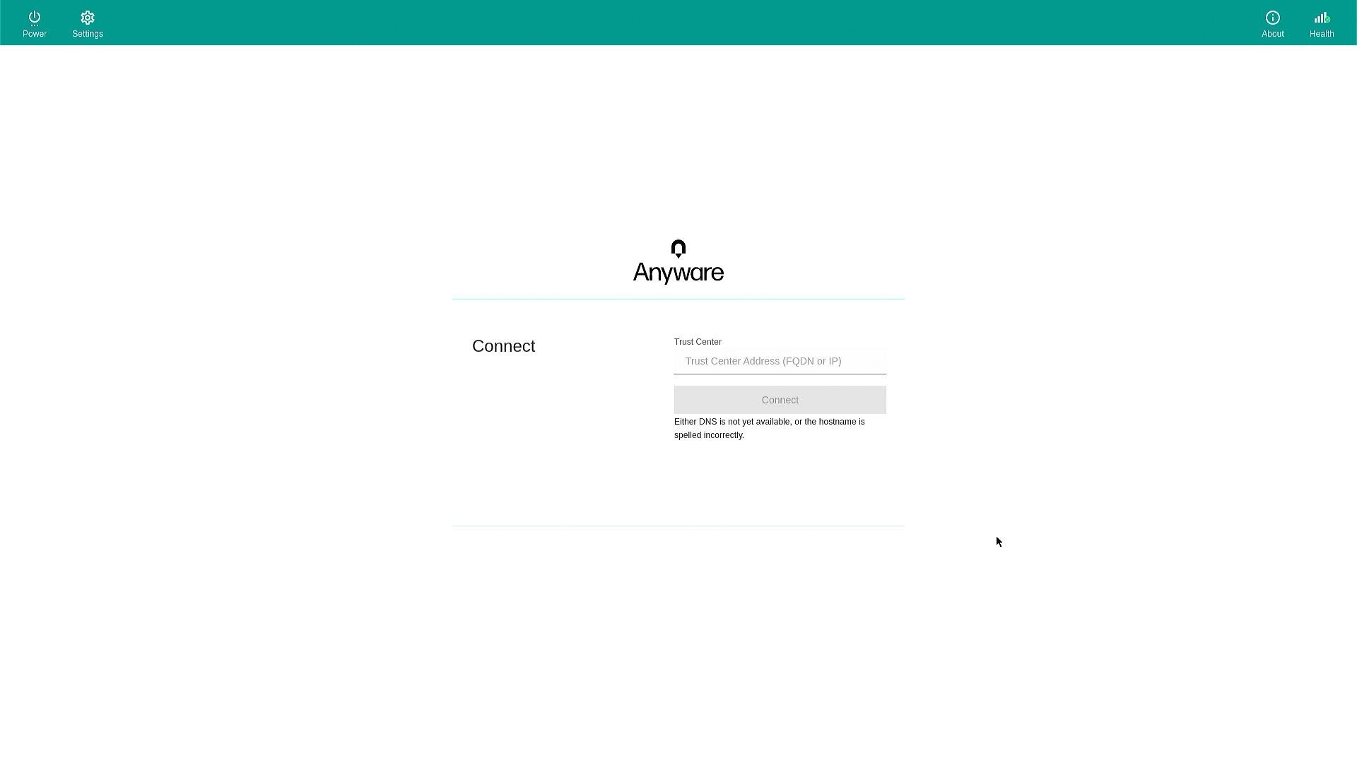

Register With Your Anyware Trust Center
Finally, register the device with an Anyware Trust Center. Once registered, your device will be able to connect to remote desktops and will be managed by the Anyware Trust Center.
Note
  • Registering with Trust Center is optional for scenarios such as for proof-of-concepts, evaluation, and air-gapped minimal environments. For production environments, we strongly recommend it for enhanced security between client and host connections.
  • If your IT administrators have already set up your network and you are on a LAN, this step is not required.
  1. Confirm that your network is configured to allow the Trusted Zero Client to reach the Anyware Trust Center on its configured connection port (by default, this is port 32443).
  2. Connect the Trusted Zero Client to the network and power it on.
  3. You will be prompted to select a language for the Trusted Zero Client's interface. Choose the language you want to use (you can change this later via the settings menu).
  4. When prompted for a connection address, provide the FQDN of your Anyware Trust Center and click Connect.
    Connect to Anyware Trust Center
If the network configuration and FQDN are both correct, the Trusted Zero Client will automatically register itself with the Anyware Trust Center.
After the initial successful connection, the Trusted Zero Client will automatically connect to the Anyware Trust Center when it is powered on or restarts.
