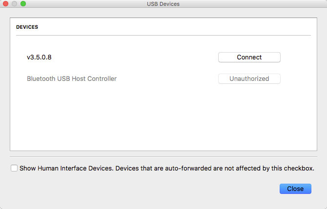

  1. Attach the USB device you wish to connect.
  2. Select Connection > USB Devices from the Anyware Client menu.
    A list of USB devices connected to your client machine appears. Integrated USB devices, such as built-in cameras on laptops, will appear in this list along with devices you have plugged in yourself.
    Some devices will identify themselves only as USB Device.
  3. Click Connect beside the USB device you wish to use.
Connecting to Human Interface Devices
Most Human Interface Devices (HIDs), such as keyboards and mice, are automatically handled by the Anyware Client and do not appear on in this list even if they use a USB connection.
If you need to connect a Human Interface Device that cannot be locally processed, like a 3D mouse or a Wacom tablet, enable the Show Human Interface Devices checkbox to reveal the device in the USB device list and click its Connect button.
You may also have to complete additional configuration steps or install drivers on the host machine.

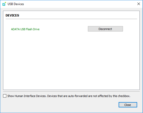

To disconnect a USB device:
  1. Select Connection > USB Devices from the Anyware Client menu.
  2. Click Disconnect beside the USB device you wish to disconnect.
