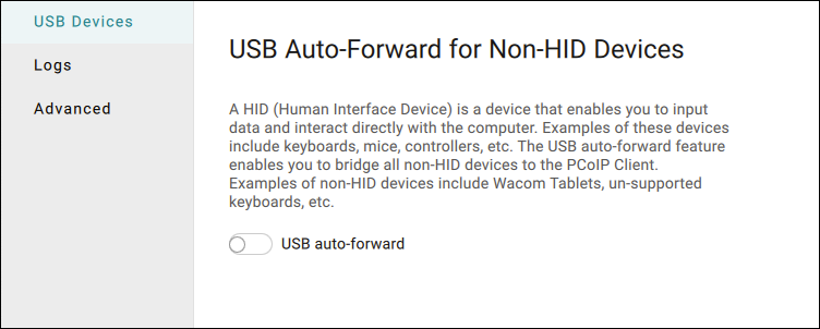

To enable automatic USB forwarding in the pre-session interface:
  1. Disconnect any active PCoIP sessions and return to the pre-session interface.
  2. Click the gear icon to open the settings window:
  3. Click USB Devices in the left side menu, then enable USB auto-forward in the USB Auto-Forward for Non-HID Devices panel.
