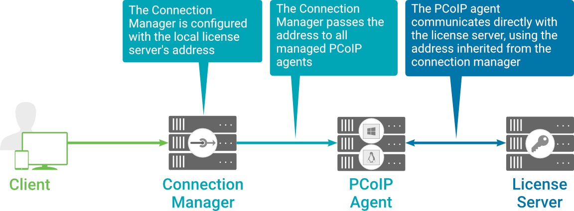

Brokered Environment Licensing
In brokered deployments, the license server address is configured in the Connection Manager, which passes it through to its managed Anyware agents.
Local license validation using a Standard Agent for Linux and a brokered connection
When using a Connection Manager, the license server address is only configured once no matter how many Anyware agents are behind the Connection Manager.
To set the License Server URL in the Connection Manager:
  1. On the Connection Manager machine, use a text editor to open /etc/ConnectionManager.conf.
  2. Set the LicenseServerAddress parameter with the address of your local license server:
    • http://{license-server-address}:{port}/request
  3. Save and close the configuration file.
  4. Restart the Connection Manager.

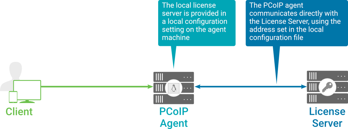

Unbrokered Environment Licensing
In direct, or unbrokered, deployments, each Anyware agent is configured with the license server address via a local agent setting. When a client initiates a new PCoIP session, the Anyware agent uses its local configuration to communicate with the license server.
Local license validation using a Standard Agent for Linux and a direct (unbrokered) connection
Each Anyware agent in your environment must be individually configured with the license server's URL.
To configure the License Server URL on the Standard Agent for Linux machine:
  1. Using a text editor, open /etc/pcoip-agent/pcoip-agent.conf.
  2. Add or modify the pcoip.license_server_path directive:
    pcoip.license_server_path = <license-server-address>
    Where <license-server-address> is the address of the license server, formatted as http://{license-server-address}:{port}/request.
  3. If the license server is behind a proxy server, provide the proxy information using the pcoip.license_proxy_server and pcoip.license_proxy_port directives.
  4. Save and close pcoip-agent.conf.
The changes will take effect on the next PCoIP session.
