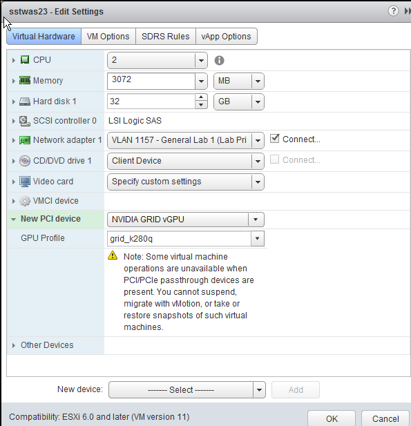

To add a shared PCI device and specify its GPU profile:
  1. Using vSphere Web Client, right-click the virtual machine in the Navigator list and select Power > Power Off.
  2. Right-click the virtual machine and select Edit Settings.
  3. In the New device drop-down list, select Shared PCI Device and then click Add.
  4. Click Reserve all memory.
  5. In the GPU Profile drop-down list, select the profile for your card. This profile determines how many virtual display heads, or displays, are available for your card.
  6. Click OK.
  7. Start the virtual machine.
