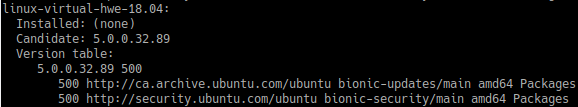

        For example, if you needed to find a kernel with a major version of 5, you would look through the output of apt-cache policy linux-virtual* and find a response similar to this one:
        The version is hwe-18.04. You will install that package and the corresponding cloud tools package:
        sudo apt install linux-virtual-hwe-18.04
        sudo apt install linux-cloud-tools-virtual-hwe-18.04
