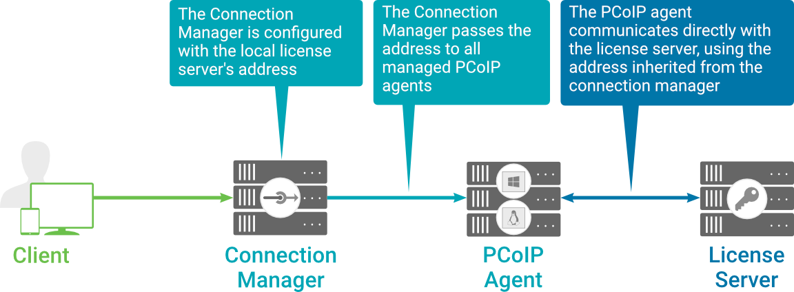

Brokered Environment Licensing
In brokered deployments, the license server address is configured in the Connection Manager, which passes it through to its managed Anyware agents.
Local license validation using a Graphics Agent for macOS and a brokered connection
When using a Connection Manager, the license server address is only configured once no matter how many Anyware agents are behind the Connection Manager.

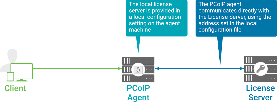

Unbrokered Environment Licensing
In direct, or unbrokered, deployments, each v agent is configured with the license server address via a local agent setting. When a client initiates a new PCoIP session, the Anyware agent uses its local configuration to communicate with the license server.
Local license validation using a Graphics Agent for macOS and a direct (unbrokered) connection
Each Anyware agent in your environment must be individually configured with the license server's URL.
