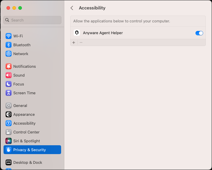

  1. Open System Settings > Privacy & Security, and select Accessibility from the list of options.
  2. Under Allow the apps below to control your computer, confirm that Accessibility is turned on for Anyware Agent Helper.
  3. If Accessibility is not turned on for Anyware Agent Helper, turn it on. This is how the Accessibility screen will look:

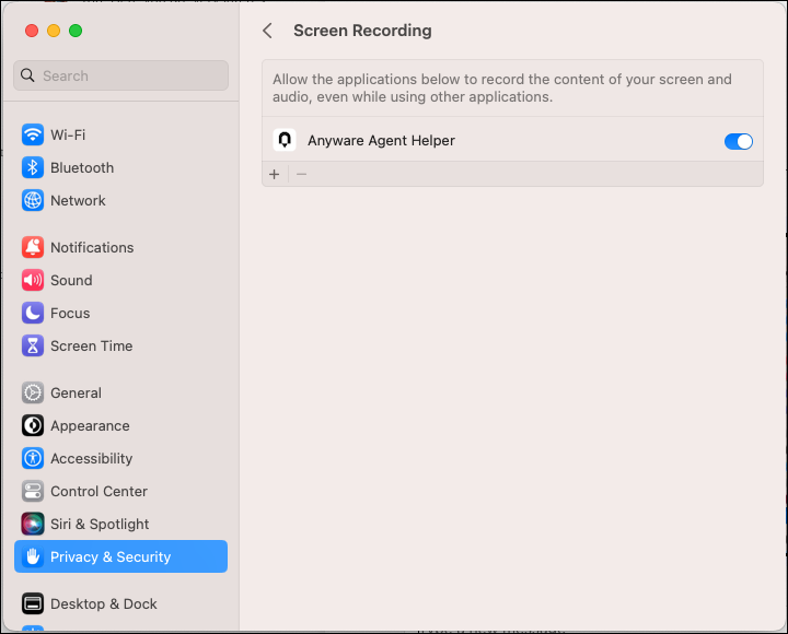

  4. Open System Settings > Privacy & Security, and select Screen Recording from the list of options.
  5. Under Allow the apps below to control your computer, confirm that Screen Recording is turned on for Anyware Agent Helper.
  6. If Screen Recording is not turned on for Anyware Agent Helper, turn it on. This is how the Screen Recording screen will look:

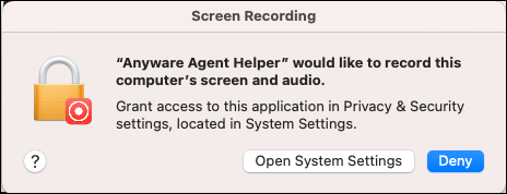

  4. From the Finder, go to Applications > Anyware Agent.app. A prompt appears requesting the Screen Recording permission.
  5. Click Open System Settings.

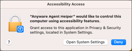

  7. From the Finder, go to Applications > Anyware Agent.app. A prompt appears requesting the Accessibility Access permission.
  8. Click Open System Settings.

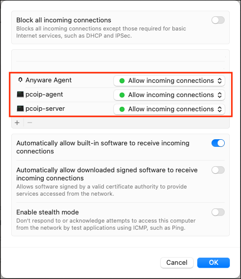

Confirm firewall settings
During installation, the macOS agent installer updates the firewall settings on the macOS machine, which enables the remote and client machines to reach one another. If you encounter connectivity issues, ensure that one of these firewall conditions is met:
  • The firewall is off, or
  • The firewall is on, and:
    • Automatically allow downloaded signed software to receive incoming connections is checked, or
    • On the remote machine, Automatically allow downloaded signed software to receive incoming connections is not checked, and the following executables are allowed through the firewall:
      • /Applications/Anyware Agent.app
      • /Applications/Anyware Agent.app/Contents/MacOS/pcoip-agent
      • /Applications/Anyware Agent.app/Contents/MacOS/pcoip-server
Note: Allowing the Executables Through the Firewall
If the firewall is on and Automatically allow downloaded signed software to receive incoming connections is NOT enabled, during installation, when prompted, allow the incoming network connections.

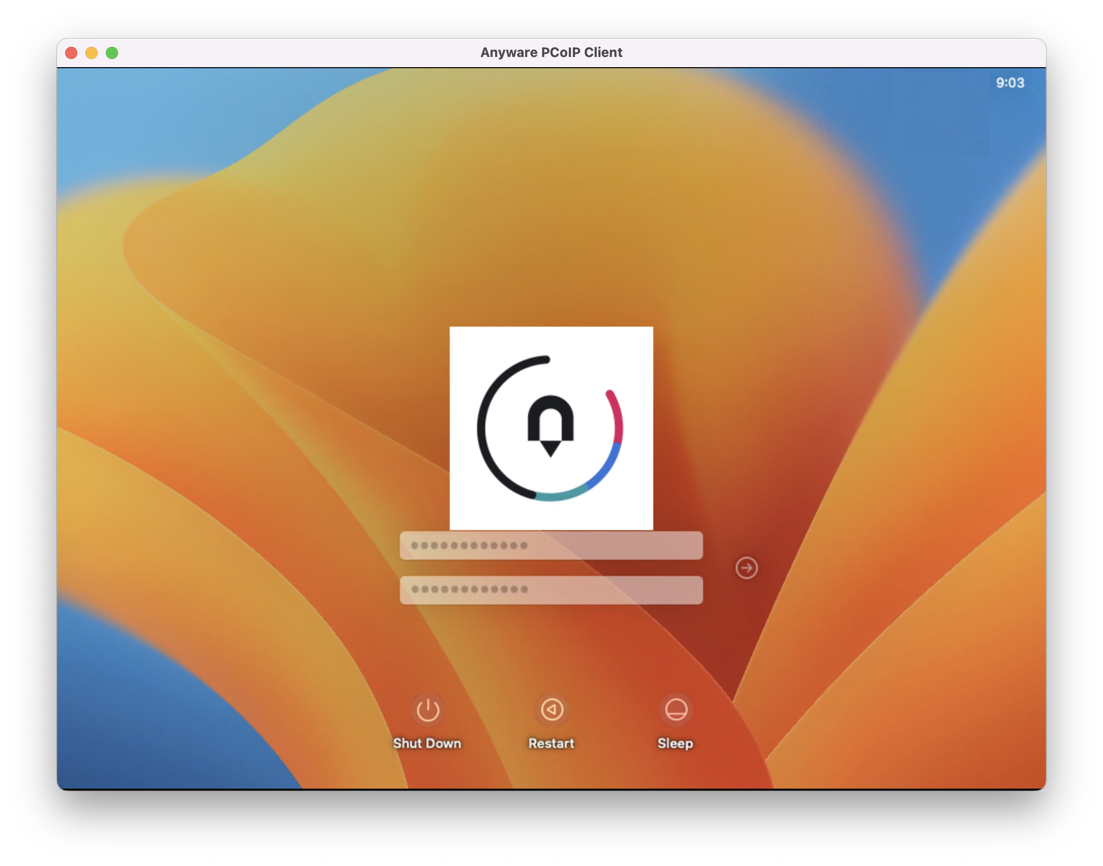

Losing connection during login
Sometimes, if a user disconnects from a PCoIP session during the login process, the macOS agent becomes unresponsive. In this scenario, the macOS agent will reboot the remote machine. If this happens while logging in, wait until the macOS agent reboots, and establish the PCoIP session again.
