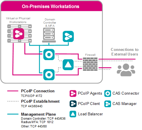

The following diagram outlines a load balancing scenario for an HP Anyware deployment with Anyware Manager integration.
Load balancers must support both HTTP and sticky sessions (jsessionid). During the session establishment phase, the Anyware Connector passes it's ExternalRoutableIP configuration value to the Anyware Client. After the session has been established, the Anyware Client uses the provided IP address to communicate directly with the Anyware Connector. TCP Ports 443/60443 can be opened for session establishment.
ExternalRoutableIP must point to the Anyware Connector
If the ExternalRoutableIP setting is configured to point to the load balancer instead of the Anyware Connector, the load balancer may direct the Anyware Client to the incorrect Anyware Connector on the wrong server and the Anyware Client will not be able to establish a session.
Anyware Connector Public IP Addresses
In the above configuration, each Anyware Connector must have a unique public IP address and it must be routable externally for port 4172.
