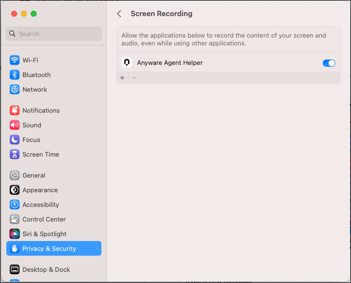

Open System Settings > Privacy & Security, and select Screen Recording from the list of options.
Under Allow the apps below to control your computer, confirm that Screen Recording is turned on for Anyware Agent Helper.
If Screen Recording is not turned on for Anyware Agent Helper, turn it on. This is how the Screen Recording screen will look:

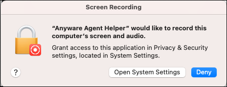

From the Finder, go to Applications > Anyware Agent.app. A prompt appears requesting the Screen Recording permission.
Click Open System Settings.
Go to Privacy & Security, and turn on Screen Recording for Anyware Agent Helper.
