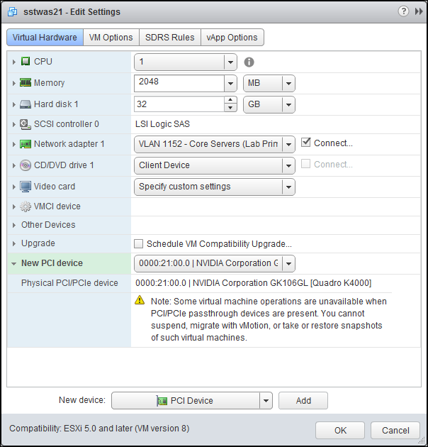

To add a PCI device:
  1. Using vSphere Web Client, right-click the virtual machine in the Navigator list and select Power > Power Off.
  2. Right-click the virtual machine and select Edit Settings.
  3. In the New device drop-down list, select PCI Device and then click Add.
  4. Click OK.
  5. Start the virtual machine.
