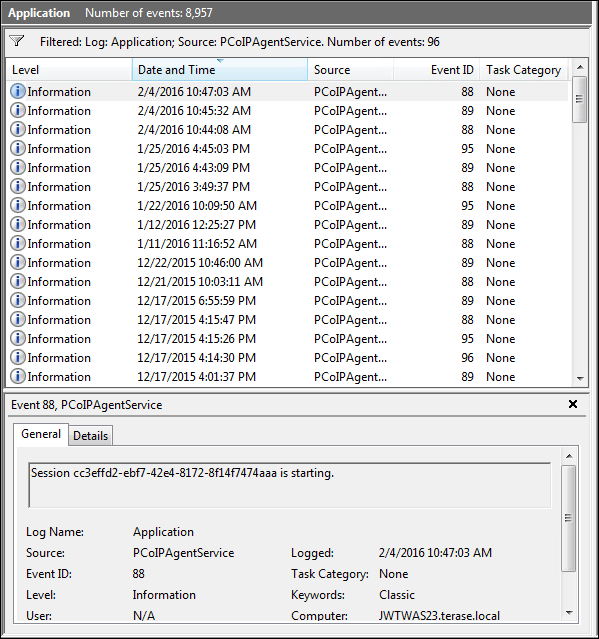

To view events using the Windows Event Viewer:
Navigate to Start > Control Panel > System and Security > Administrative Tools and double-click Event Viewer.
Navigate to Event Viewer (Local) > Windows Logs, right-click Application, and select Filter Current Log.
In the Event sources drop-down list, select PCoIPAgentService and click OK.
Select an event to view its details.
The next example shows typical Anyware agent session and connection events that you can view in the Windows Event Viewer.
