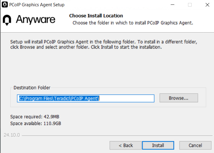

  6. Specify an installation directory and click Install.
    By default, the software will be installed in the C:\Program Files\Teradici\Anyware Agent directory.
    The Anyware agent files will be installed on your desktop.

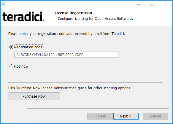

  7. Provide your licensing information on the License Registration screen:
    Important: Local license server users
    If you are using a local License Server, do not enter a registration code here. Select Not now and then click Next instead. You will configure your license server information later.
    Type or paste a registration code in the Registration code field and click Next for the proxy settings screen.
    • If you use a proxy server to access the internet, select Use a proxy server for Internet connection and specify the address and port numbers of the proxy server, then click Next to register the license.
    • If your system does not use a proxy server, leave this screen unchanged and click Next to register the license.

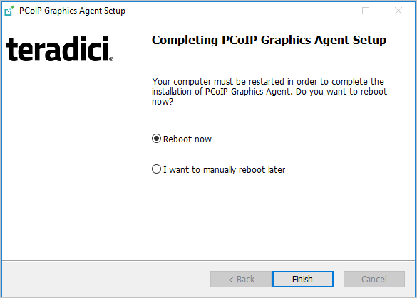

  8. The Windows desktop must be rebooted to complete installation; you can choose to do that now, or do it yourself later. Some features may not work until the system is restarted.
  9. Click Finish to exit the installer.
