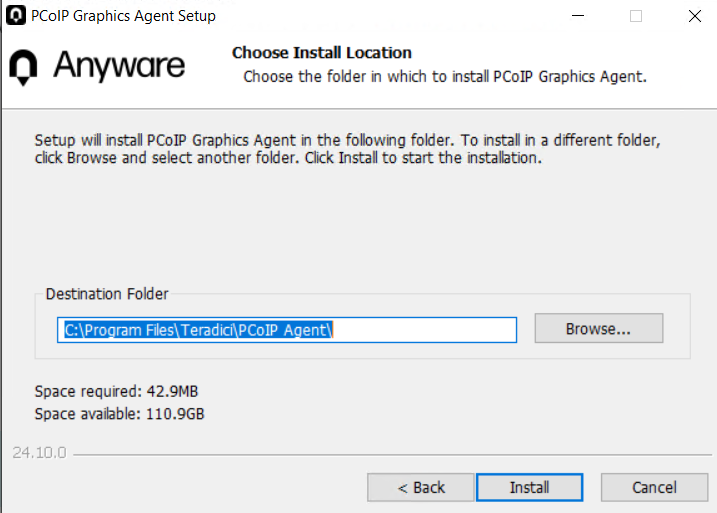

  6. Specify an installation directory and click Install.
    By default, the software will be installed in the C:\Program Files\Teradici\Anyware Agent directory.
    The Anyware agent files will be installed on your desktop.
